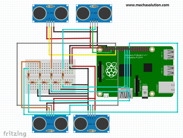

The HC-SR04 ultrasonic range finder is very simple and cheap to use. Unlike Arduino Uno R3 operated by 5V, Raspberry Pi reads 3.3V signal so the 5V output of the HC-SR04 needs to be converted from 5V to 3.3V.
There are some useful breakout board converting higher voltage to lower voltage but voltage dividers can adjust the voltage level easily by using the simple arithmetic calculation.
In this tutorial, 1K ohm [ Brown-Black-Red] and 2K [Red-Black-Red] resistors are used to convert the 5V to 3.3V.
WIRING
cba7d75088069cd02a9535379e0eb2c0_1456731
Wiring four ultrasonic range finders with Raspberry Pi is not easy so we recommend to use cobbler cables to extend the 40pin GPIO to the breadboard or to adopt the protoshield. Basically, VCC (5V) signals are all 'red' colors while GND signals are all 'black' colors.
