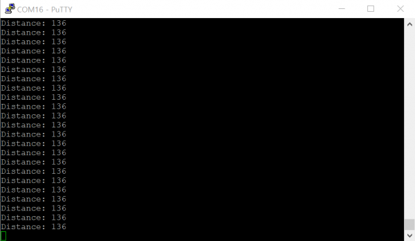

6.    Putty로 모니터링
1f7c3ee5d7e718d5cf0b1a77c77892dc_1536645
